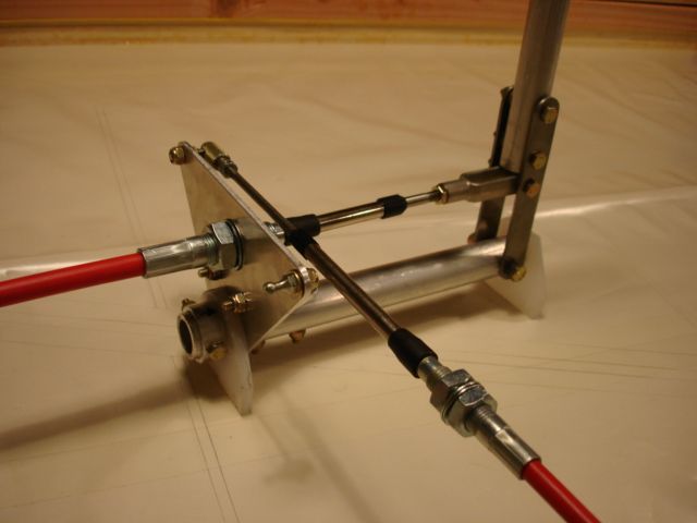

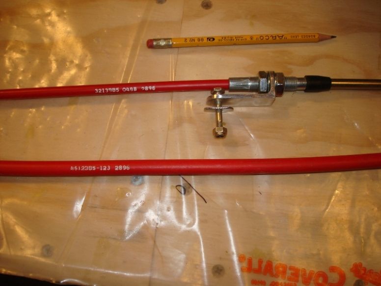

Вот такой трос используется на хаймаксе (оригинал) на конце оболочки резьба, с помощью которой можно зафиксировать трос.

Вот выдержка из STRUCTURAL ANALYSIS OF THE HIMAX
ULTRALIGHT/EXPERIMENTAL AIRCRAFT
I. CONTROL SYSTEM
Maximum hinge moments for each control were determined from
in-flight stick force measurements for the elevator and from
reference 1 for the aileron and rudder loads.  Loads thus
determined are:
Elevator  207 in. lbs
Ailerons(each)   253 in. lbs
Rudder   167  in. lbs
1. Elevator:
The elevator is actuated via a heavy duty push-pull armored "Morse" cable, connected directly to the control stick.  The elevator horn is 2.25 inches from the hinge line to the pushrod, giving a total force (compression) of 92.6  pounds.  The manufacturer's rating for the cable is 100 pounds compressive. Static tests were performed on the elevator control assembly.,. The cable was loaded to a total of 278 pounds where failure occurred.  This corresponds to a safety factor of 3.0
2.Rudder:
The rudder and steerable tailwheel are actuated by separate 1/8 inch braided cable.  Maximum calculated load in the cables is only 56 pounds, far less than the cable strength.
3.Ailerons:
The aircraft has full span ailerons which (optionally) can be operated as flaps (flaperons).  The ailerons are actuated by push-pull armored cables rated at a usable load of 80 pounds compression and 100 pounds tension by the manufacturer.  The aileron end of the cable housing is attached to the flap actuating arm which controls simultaneous deflection of the left and right surface to achieve flap deflection.   Maximum calculated load in the cables is 73 pounds in tension. Compression loads are substantially less, since the normal aerodynamic load on the aileron tends to maintain the control cable in tension.  To ensure adequate strength, a static test of the flaperon system was done.  The ailerons were loaded so as to load the cables to 1.5 times the maximum calculated load of 73 pounds, while the ailerons were exercised to ensure proper operation.

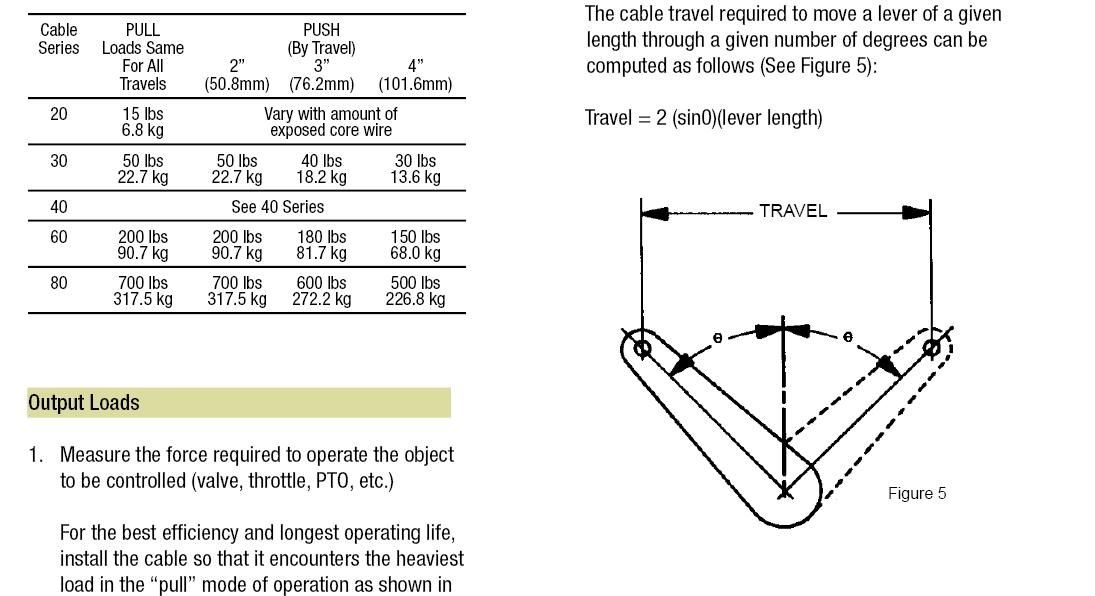

В личной практике сталкивался с такими тросами на горной технике, старых экскаваторах Komatsu. Там трос диаметром жилы 3-4мм,  установлен от кабины до рычага регулятора ТНВД, длинной метров 6-7, работает годами по 22 часа в сутки, ни люфтов, ни других проблем, пока не износятся уплотнения и не заклинит от набившейся под оболочку грязи. Весчь крайне надежная, не перетирается и не переламывается при правильном монтаже, довольно жесткий по жиле и по оболочке. Думаю, такого троса, диаметром 5 мм хватит для передачи усилия до 20 кг в прямом и обратном направлениях...
Вот, нашёл, случайно, в закромах родины 🙂
Тут есть и про усилия и про остальное.
Рафис!
Спасибо тебе огромное.!!!!!!!
Это уже ого-го сколько  😀 Во всяком случае есть зависимость от толщины жилы и нагрузка на сжатие от хода вне боудена и градация по каким то сериям. Остается со всем этим разобраться и соотнести с нашими нормированными нагрузками. Что то обуревают меня смутные сомнения, что маловато может быть для троса в 3-4 мм 😱.  Потребное скорее от 4,5-5 мм. Это ж жуть сколько  :-?
