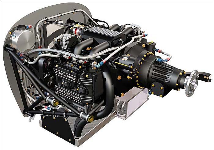

Пришла инфа о двигателе Субару. Выкладываю тут пока без перевода:
RE: Crossflow CF4-20T Engine Solution for Velocity SE
Dear Dmitry,
Thank you for inquiring about our products and services. Firstly, I want to express to you that Crossflow Aero Corp. is a state-of-the-art operation that manufactures the highest quality engine solutions possible. We’ve gone to great lengths to make sure all our processes meet Aerospace industry standard practices.
The Crossflow CF4-20T Engine Solution provides a comprehensive solution for those in need of a high performance aviation power plant in the 200hp range. Our engine solution package provides you with all you need to prepare your Velocity SE for powered flight. The CF4-20T package includes:

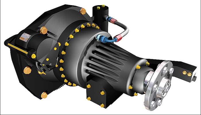

Crossflow Aero Corp. CF4-20T engine
Crossflow propeller speed reduction unit
- The Crossflow Aero Corp. Propeller Speed Reduction Unit (PSRU) is an internal spur gear reduction drive of proprietary design that had undergone 3 years of research and development. It has been specifically designed to work with Subaru automotive engines converted for aircraft use by our engineers. The PSRU employs some unique features that we believe make it the best choice on the market for Subaru based aircraft engines:
- All internal drive components are CNC machined from 4340 certified Aerospace steel billet
- Gears are nitrided using the controlled Nitreg process resulting in the formation of a hardened surface that reduces fatigue and wear together with improving resistance to seizure.
- Internal bearings (angular contact and spherical rolling) are Aerospace quality
- Gears are made to AGMA 10
- Micro lash adjustment on housing for proper gear tolerances
- Internal gear design allows for high contact tooth ratio with torque rating of 780 ft/lbs
- Viton® oil seals to withstand temperatures up to 400°F
- Anticorrosion nickel-plated prop flange drilled in SAE 1 & 2 or Continental bolt patterns
- Custom built flywheel with built-in Sachs torsion damper
- Gear lubrication by fully synthetic transmission fluid.
- Built-in oil recirculator
- Oil temperature probe and gauge incorporated
- Drive can be used in either tractor or pusher configurations
- Facility to install oil cooler, if required.
Customized stress relieved engine mount for Velocity SE
- Built using aerospace industry materials and techniques.
- Includes LORD engine mounts and 'AN' hardware
Engine control unit and electrical harness
- The Crossflow Engine Control Unit is specifically programmed for aircraft use and is one of the most advanced, flexible yet affordable engine management systems available anywhere - supplied with the ultimate in carefully refined software. The unit features a 32 MHz processor, employs extensive data-logging capabilities and is housed in a very sturdy billet machined enclosure.
- All of our Crossflow engine electrical harnesses are designed and manufactured to MIL standard specifications to meet the highest quality demands for reliability. Each harness is hand-built with particular attention to wire shielding, wire integrity and end fastening.
- Pre-wired engine with Cannon type quick connect firewall plug
- All wiring is aircraft Mil. Spec. MIL-W-22759/16 covered with Cole-flex nylon braid fire resistant sleeving
Engine cooling system
- Crossflow Engine Cooling Systems are fabricated from aluminum matrix air/liquid heat exchangers and aerospace quality plumbing.
- All ducting, brackets, hoses and necessary 'AN' fittings
Engine exhaust system
- Crossflow Engine Exhaust Systems are designed to your aircraft cowling's specific geometry and configuration and are welded out of high quality mild steel which is then ceramic coated internally and externally.
- We also offer the option of a stainless steel exhaust system. This system costs US$800.00 above the existing package price
Engine maintenance kit
- The kit contains sufficient items to maintain the engine installation for up to two hundred hours of engine operation or one calendar year. It includes:
- Alternator belt
- Timing belt
- Oil filter
- Air filter cleaning kit
- Fuel filter
- Oil pan plug gasket
- Spark plugs.
Engine maintenance schedule
- A printed maintenance schedule particular to your engine model is provided.

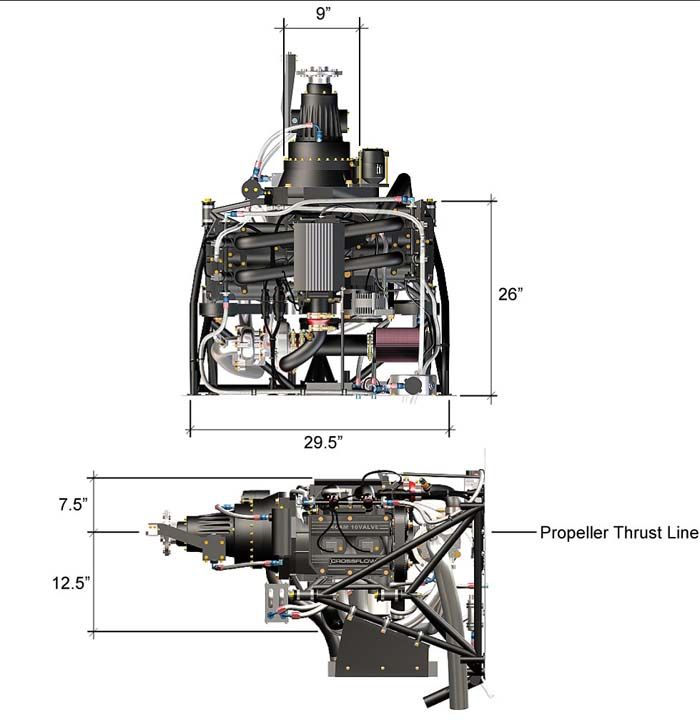

Crossflow CF4-20T Engine Solution Specifications
Performance - 200 horse power at 6000 rpm
Reduction ratio - 2.34:1
Compression ratio - 10.1:1
Torque at propeller - 428 ft / lbs
Fuel consumption at 80% power - 8.7 gallons per hour (33 литра в час)
Displacement - 2000 cubic centimeters
Bore - 92 millimeters
Stroke - 75 millimeters
Alternator - 55 amps
Spark plug - NKG Racing
Fuel - Premium automotive fuel or 100 LL
Oil - 5W50 synthetic
Cooling Liquid - 100% BASF glysanthin
Fuel system - Multi-port fuel injection
Ignition - Multi-coil – 1 per cylinder
Weight - Under 360 lbs wet  (162 килограмма с маслом и охлаждающей жидкостью)

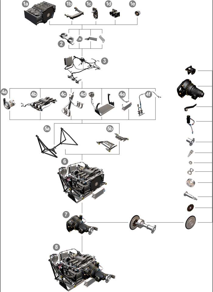

The Crossflow Manufacturing Process
The Crossflow manufacturing process has been refined over many years of development in an effort to create a thoroughly safe, high performance aviation engine. The highest levels of quality testing have been adopted from Aerospace industry standards. Our manufacturing process follows these steps. Details of each step can be found on the following pages:
    59,7 КБ · Просмотры: 259
1. Engine disassembly, inspection, and reassembly
- Engine block and cylinder heads - Each Crossflow engine is imported directly from Japan. We strip the engine down completely, removing every single part from the original engine. We’ve intentionally chosen to begin with used engines particularly from Japan for several reasons. Firstly, Japanese environmental law requires that every automotive engine be rebuilt after 50,000 kilometers. This is an ideal situation for the Crossflow engine because after this relatively short engine operation time the Subaru aluminum long block has been conditioned by heat during its use. This ensures that the block has no cracks or flaws in the casting. This mature engine block now becomes the core of the Crossflow power plant. Every other component used in a Crossflow engine except the cylinder heads, crankshafts, connecting rods and valve covers is custom fabricated here at our facility and/or ordered new directly from Subaru. These are the steps taken with the engine block and cylinder heads:
i. Clean cylinder heads
ii. Port Polishing
iii. Sand Blast & Grind valves
iv. Cut valve seats
v. Valve lapping
vi. Cylinder head & accessory re-cleaning
vii. Reassembly
viii. Cylinder head pressure test
ix. Clean Valve cover, sandblast and paint
x. Clean Cams and Cam Caps
- Cooling system bridge – We remove all of the original hose ends. Several new holes are drilled and tapped to support the water temperature sensor. As well, to accommodate the Crossflow conversion we cut the system bridge and re-weld it in a slightly different angle. The system bridge is then painted.
- Water pump – The water pump is completely disassembled and inspected for flaws or damage. Several stock holes are plugged shut.
- Throttle body – The throttle body is disassembled and inspected for flaws or damage. It then has various modifications made to it to accept the Crossflow intake manifold and manifold pressure sensor.
- Trigger wheel – The stock trigger wheel is cleaned and several modifications are made to it for compatibility with the Crossflow ECU.
2. Custom parts fabrication
Various small but significant custom parts are fabricated for a Crossflow Engine. Using our CNC mill and lathe, we fabricate a proprietary intake manifold, various brackets and small support structures for different parts of the engine. Every custom part is first designed in an industry standard 3D software modeling application. Our engineering staff performs virtual stress tests on ever part before the design of even the simplest bracket is approved. The newly approved part design is then loaded onto our CNC mill and/or CNC lathe and is fabricated quickly and efficiently from aerospace standard 6061T6 aluminum.
3. Electrical wiring harness
The Crossflow electrical wiring harness is designed and manufactured to MIL standard specifications to meet the highest quality demands for reliability. Each harness is hand-built with particular attention to wire shielding, wire integrity and end fastening. Cannon type quick connect firewall plugs are used for easy installation to the firewall. All the wiring used is aircraft Mil. Spec. MIL-W-22759/16 covered with Cole-flex nylon braid fire resistant sleeving. Each wire used is cut specifically to the length of that is needed, sheathed and tied down securely to the engine to minimize vibration and to keep the engine very neat. Once the harness is complete and electrical continuity test is performed on the entire harness.
4. Custom parts fabrication, modifications and assembly
- Turbo – The turbo is disassembled, cleaned and inspected. Welded modifications are made to the waste gate and then it is reassembled.
- Intake manifold system – The Crossflow intake manifold system is completely fabricated from new. The plenum box is cut and welded. The manifold intakes are digitally designed for optimum performance and then cut on our CNC mill. Tubing is cut and fitted. The entire manifold system is then welded together.
- Exhaust system – The exhaust system is fabricated in three parts. The exhaust manifold is designed digitally and cut using our CNC mill. The manifold to turbo transition pipes are cut out of mild steel or stainless steel and then fitted to the turbo and exhaust manifold. The exhaust down pipe is then cut and fitted. A hole is drilled and a threaded boss is fitted to support our exhaust gas oxygen sensor (EGO). The entire exhaust system is laid out on our custom welding jig and welded together. The welded system is then sent out to a third party to be entirely ceramic coated. The returned exhaust system then has the EGO fitted and is ready for the engine installation.
- Water cooling system – Our radiators are fabricated from aluminum matrix air/liquid heat exchangers and aerospace quality plumbing. They’re TIG welded and have customized mounting brackets designed and installed for various aircraft type applications and installation locations.
- Oil cooling system – Our high performance oil cooling system utilizes A-N aircraft fittings with stainless steel braided hoses. They’re TIG welded and have customized mounting brackets designed and installed for various aircraft type applications and installation locations.
- Fuel pump system – The fuel pump system is assembled using custom fabricated parts, A-N aircraft fittings, high performance fuel pumps, fuel filters and a fuel pressure sending unit.
5. Engine mounting system
- Custom engine mount – Depending on the aircraft application, the engine mounting configuration is setup on our custom adjustable firewall welding jig. Our engine mounts are constructed using chro-moly steel. The tubes are cut and fitted exactly to the mounting specifications and are stress relieved for optimum strength. The mounts are designed to transmit the least amount of vibration possible into your aircraft. The mounts are then spray painted using high quality, durable enamel paint
- Engine cradle – The engine cradle is fabricated by CNC machining the mount seat adapter and cutting and fitting chro-moly steel tubes. The entire cradle is then secured to a customized welding jig and welded together. The cradle is then spray painted using high quality, durable enamel paint.
